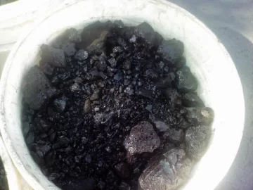

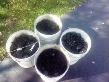

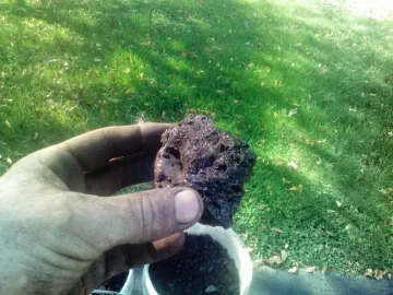

I am posting this to give some perspective. I see guys on here all the time who who freak out if they get a gallon of stuff their chimney. I agree that is not as good as it should be with a modern stove but here are some pics of what i took out of one chimney today.
[Hearth.com] This was a dirty chimney [Hearth.com] This was a dirty chimney [Hearth.com] This was a dirty chimney
Yes that is 20 gallons out of a rectangle stainless lined and insulated chimney and there was another 3 or 4 that hadn't been brought out yet
Wow! They are lucky they didn't have a serious chimney fire. That's a lot of fuel. What stove do they have?
An efm wood boiler. And wet wood. I took almost that much out last year as well. That one was really bad but it is not uncommon to get over 5 gals out of a chimney. We also have lots that are less than a gallon though. And there were a few fires i am sure
The wost one i have done so far was 65 gals. They had a 12 by 12 almost plugged the entire 35 feet. The one today was only 22 feet

No they are not they know it is not right but we have been trying to work with them on it but they will not change. Some people just wont change
It must not bother them too much if they resist changing their habits after seeing the results.
I think "You are going to have a chimney fire..." would be part of my discussion with them.

yeah they got allot more work for the same amount of money. Well not the same we did charge more but not four times which is about how much longer it took. We did tell them the price will go up each year though if things don't change. The first year was a normal sweeping price this year was almost double

My point in posting this was not to bash them it was to give some perspective. Most of us here are a little opsessive about wood burning and do it well. And we also pick apart people just starting for doing little things wrong. I just wanted to show that most people here even the ones doing things not quite right are way better than many others out there.

Odd they are conscientious enough to call for routine cleaning but not enough to feed more air or burn better fuel.
It is not that they are conscientious it is that they have learned that if they try to go more than a year it plugs up and they cant burn. And the way it is now they cant clean it. Hell we cant even get it completely clean.
I originally was going to ask if they were waiting till the system was giving them trouble before they called. There's my ans.
That was what happened the first time we were called out after putting in the liner but now they call every year
