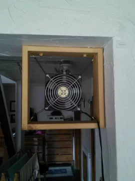

I just installed several of those. Although I installed mine above the doorway pulling hot air from the stove room to my other rooms. That's the only place I could possibly install them.

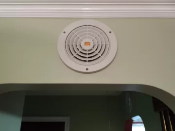

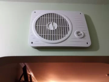

I have these all over the house....four inch fan....
Oak Ridge Manufacturing
Woodman's Parts Plus
Wakefield, NH 03830
