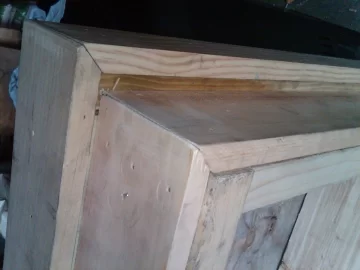

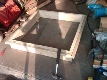

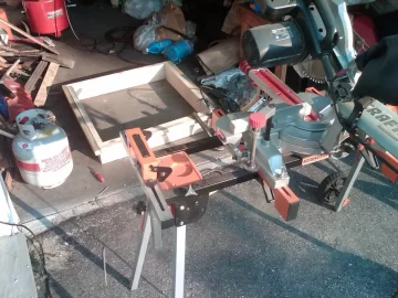

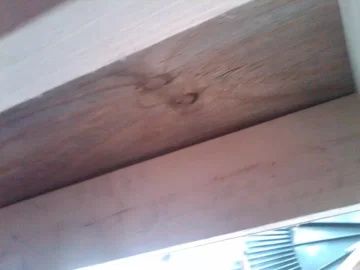

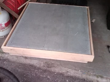

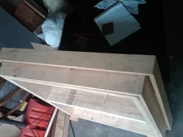

Well this is fairly simple 9 - 12" square tile hearth for a friend. Hearth with amber rope light in a 1/2" groove in the overhang with 2x6s and 1" solid pine trim. Cement board and Sand color ceramic tiles with Sandstone color grout and a 1/4" finished plywood back.
See pics.
