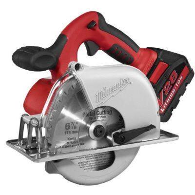

circular saw with metal cutting blade [fiberglass disc thing]

here is a link with a picture...
Unfortunately the spaces in the URL break the link but a copy/paste works. Cool tool!
