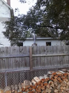

My neughbor just out in a new stove. here is a pic of the new pipe he installed. i was thinking even a double walled pipe was not suppose to toucj wood ???

Nope. Looks like there's more than one problem there too. Improper T support for sure. Is there a roof brace at the 5' level above the low roof? Is the 10-3-2 rule being honored for the adjacent higher roof? Lord only knows whether the thimble is correct, hope so.
If you are friendly with them tell them to come here for a checkup. If not, at least have your garden hose and extinguishers ready.
Friendly HA they hate mr for no reason and the feeling is mutual! There unfreindly uppity Yankees that think there super smart highly educated and I'm redneck trash. Funny thing is that she just got her college degree and is a TA now but she says she teaches college. She's early 40s me I have a post bachelors. But they don't bother to know me. I get along with every in town them no one. Anyway nope no brace, I'd say its far from other roofs?? Explain the numbered again. But they will get some funky draft with 2 higher roofs and a tree right next to it.

There easy 3 ft higher than roof but at 10 past the pipe?? That roof makes an A to a peak beyond the pipe. Basically the from large roof runs east west and the back half of hose is an A that runs north south.

To discuss this newly installed SS pipe. There is wood bracing touching it !!!

But i am pretty sure wood is not suppose to touch your pipe!!!

I do know my 6 inch Dura-vent basically needs a clear 14.5 X 14.5 opening to pass through and touching anything combustible is a no way thing.

OK I saw it from a different angle. The pipe does not actually touch the wood there is a metal strap the holds it to the wood bit it does not appear to touch I don't think.
One point support for the chimney is not good. They need a proper tee support to handle the weight.

Well the pipe is strapped down,? Its not really supported by the wood bracket. Its hooked to the eave though in a support bracket .
