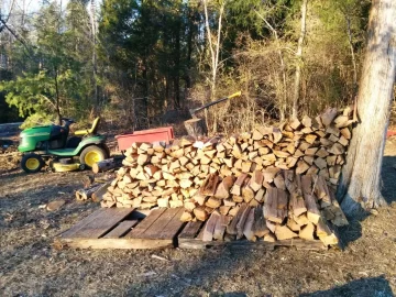

In the mean time, enjoy this photo from this weekend after just a few hours with the X27 on some standing dead oak I felled. I've got a lot of logs to process and this area facing south gets a good breeze and will hold 10+ cords. I've got this small stack now but I won't quit till it's all split and stacked. Critique on this wood pile setup is welcome (if slightly off topic).
[Hearth.com] Torn on which of these 2 stoves to purchase
