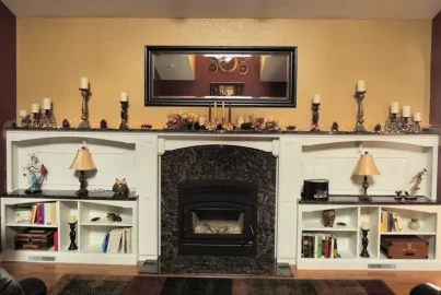

We removed our original ZC prefab and replaced it with a ZC Valcourt FP10 Lafayette (EPA).
We had the new install professionally done (for insurance purposes).
I removed the windows and constructed the bookcase / mantel.
