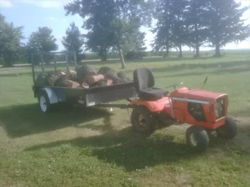

Didnt have my pics uploaded for my last post but got this one uploaded today. Not a pretty tractor but here is my 129 cub (1973) 12hp. pulling my 6x10 trailer 1400# empty weight 3500# axles. Not sure how much wood is on it, its pretty full and heaped but loosely. It'll pull this with the throttle barely over idle on flat ground.
My Cub 1000 (with the better tires & weights) is down since summer waiting for me to put in a new clutch so my 129 has been doing everything this summer, from mowing the grass to tilling the garden and hauling firewood. That one cost me $325 off craigslist with the 44" deck, ran good, but I did get it running like a top after adjusting the points. I have added antifreeze in the tires and chains (also my snow plow / snow blower tractor), the IH 3pt lift with sleeve hitch adapter, helper spring, and lights (yeah, back then lights were an option, and most didnt come with them). The good tires are on my 1000, need to get another pair of V61 front tires to replace the balloons. I also have a parts 1450 cub that I plan on swapping out the hydro to get a hydro lift on my 129 to help with plowing and tilling.

There are far better tractors out there, but for the price these old cubs are great and very versatile IMO. I even plan on setting one of my 129's up just for logging, more on that to come maybe next year.
Looks like somebody is trapped under the hood and trying to grab yer son, lol.

That looks like what I was hoping might work. A small-ish tractor capable of pulling the full #3500 trailer. And about the right price.
I gather there is a difference between a garden tractor and a lawn tractor? Which is the Cub 129?
GT. The LT version had brigs instead of kohlers, right angle belt drive instead of a driveshaft, and weaker manual trans. Cosmetically they looked the same though. If you want to look into cubs more closely, check out this website http://www.ihcubcadet.com/ half way down you'll see a listing of every model number of IH built cub cadet GT's, and some quick info that defines the model. But basically the first numbers are the HP and the last number(s) are the series. Some dont follow that exactly. IH only built em until '81, after that was MTD/CCC, and many believe quality went downhill even though some of the later tractors were much larger like the SGT's. My interest is primarily on the actual IH built models.

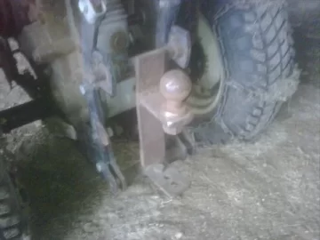

Also realize that most never came with a ball hitch, so you'll have to fab or purchase something. One good place to go for custom machined cub parts & implements is http://www.xtrememotorworks.com/ (click on the 'cub cadet parts' in the middle) I have purchased several parts from him including my ball/pin combo hitch and beefier hitch brackets. Here is a pic of my hitch setup on my 1000:

You dont need the 3pt/sleeve hitch to just pull wagons around, and they are more rare to come by. The link I provided above has a few hitch options for relatively cheap that will bolt right on and give you both a hole for pin hitch and ball hitch. I went with the lifting sleeve hitch for things like plowing dirt and tilling. Its also nice to back up to a trailer, lower the hitch, back under it, and lift the hitch up right into it.

LOL Didnt realize my gloves made it into the picture. Yeah between loads I like to air em out... all the levers and such make excellent spots to air dry the gloves and keep em with me.

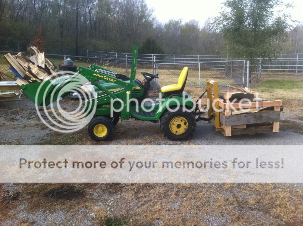

I've got both a tandem axle trailer (7,000 #) and single axle trailer (3500 #). I regularly tow both with my X720 JD. But I wouldn't tow with that much weight, due to the braking. Make a extra trip or two to do it safely, and also it will create more seat time. But here is a picture of my baby hauling wood this morning.

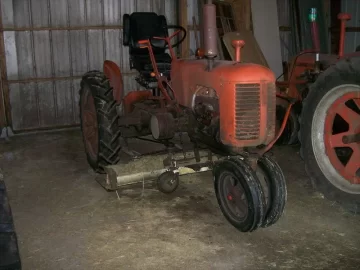

And Solar - its air ride too. Check out the seat on my big mower:

So, is that a lawn, garden or sub compact tractor? :lol: Beautiful machine.

None of the above. In 1939 when that thing was built, it was considered a full size farm tractor. Originally at 24HP and now pumped up to about 27HP.
