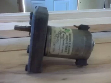

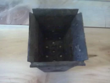

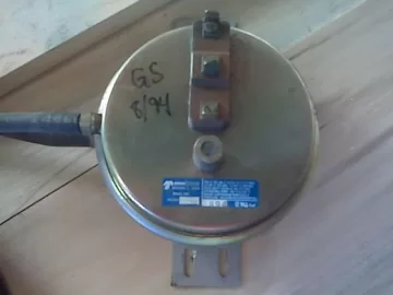

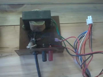

I just tore down my old trailblazer shop heater, and kept the parts for someone that would have a use for them. I don't know if your stove uses the same parts, but if it does you can have them if you don't mind paying shipping.
Rick

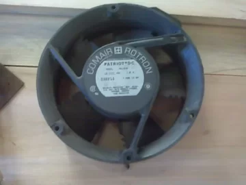

Hey Rap, a question on that ComAir Rotron fan you have in the pics.....that was the fan they used for the room air blower?
I recently saw someone selling those fans to use to send warm (or cool) air between rooms through a wall. How noisy is it?
The fan is quiet, but runs on DC. The Trailblazer only has one fan. It's a positive pressure stove, and can be a little scary to use if you forget and open the door with it powered up.

Thanks for the info Rap. That company makes all kinds of fans & blowers, including 120 vac. Was just wondering how those "bat wing" fan blades worked, noise wise. Was think of installing one between my great room where the pellet stove is, and the master bedroom for warm air at night.....obviously need it to be pretty quiet.

There was really no noise from the fan when the stove was running, so if the new ones are like this one you'll be in good shape.

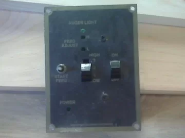

What is the startup proceedure for a trailblazer ?
Fan starts easy enough but can't figuire out the auger.
Plastic button missing on start auger button.
You have identical picks of the control panel.
I would throw a dozen or so pellets in the pot, add some gel and light it. I'd wait a couple of minutes close the door and hit the auger button. If your auger button is missing can you stick a toothpick in the hole to start the auger?
Tried the toothpick ... Nothing.
Stuck a nail in there and an electrical spark and auger started working !!!
