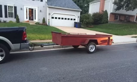

Hey All,
I picked up a used single axel trailer on craigslist. I was suprised how well it was made. Very heavy duty with solid steel sides. My primary use for it is to haul firewood. My concern is that the trailer has a 2000lb axel and 13" tires rated at 1300lb. Is this sufficient? Trailer was so cheap I thought I could change the axel and tires if needed. I found they make 3500 and 5000lb axel assemblies in my size. Is this overkill? What do you guys use?

This is a photo of trailer. Thanks

In my opinion, you cant have too much axle. I would rather know i have enough axle for what ever i want to do. I would go with the 5200lb. It maybe a little overkill, but your not gonna have any problems running down the highway loaded. You can also run a little bigger tire too.
[QUOTE My concern is that the trailer has a 2000lb axel and 13" tires rated at 1300lb. Is this sufficient? [/QUOTE]
That's 1300# EACH tire. that would be 2600# for the tires. I agree that you can't go too heavy on the axle.
When considering a heavier duty axle , typically trailers over 3000# capacity are required to have breaks. Will the tongue and trailer frame handle the larger load?
I think this is location based. In IL my 3500# trailer is not required to have breaks. As a matter of fact, my old tandem axle trailer (sold) didn't have breaks either.
Anyhoo - that appears to be a 5 X 8 trailer. Piled oak rounds could bring weights upwards (maybe in excess of) 3500# pretty quickly.
Be aware - its more than just bolting up a larger capacity axle. Springs, connection points, framing, tongue all have to be taken into consideration.
Reactions: duramaxman05
My tongue doesn't look like it would hold 5k. I plan on doing the 3500lb axel upgrade with new springs, tires and wheels. Should be a nice 5x10 wood wagon when it's done. My last load blew a shock on my Ram 1500. Looking forward to the trailer. For now I just won't load the thing too full and hope it makes it home. Thanks!

I have a 1500 Ram. Blew out a rear shock and flattened the coil on my last haul. That's when I decided to find a trailer.
I'm not saying that a heavier axle is all you need to increase GVW, all it will do is reduce the chances of a bent axle. In all reality 3500# is not heavy enough for a wood hauler. a 6000# trailer really is not enough.
