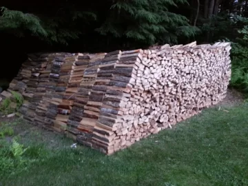

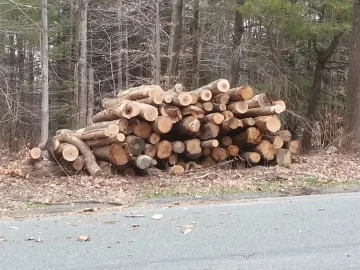

What started as this,
[Hearth.com] Transformation, Experimentation, and Calculation
Is now this, (the cube is the experiment)
I measured an equivalent length (taking into account the end slopes) of 175", depth of 165" and height of 60", and came up with 7.8 cords. Are my calcs right? If so, I'm pleasantly surprised. I didn't see the log truck that dropped the load.

Next experiment: How much faster will the outside rows dry compared to the middle rows?

Nice neat stack of wood there. Your calculation is correct, feel free to round it up to 8 cords.
I would think that putting some more airspace under it could have aided greatly in the interior drying out.

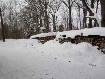

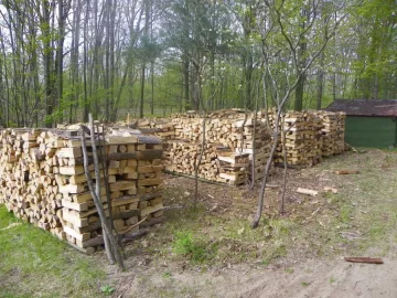

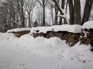

Most of you have seen these pictures before so I apologize to you but just wanted to make a point. Questions always seem to arise about the middle of the stacks not drying. Check out these stacks.
[Hearth.com] Transformation, Experimentation, and Calculation [Hearth.com] Transformation, Experimentation, and Calculation [Hearth.com] Transformation, Experimentation, and Calculation
We have stacked wood like this for many, many moons now and have had well over 20 rows together. The funny part is that we stack all the rows the same height and they all also shrink as they are drying. I've always wondered why the middle rows shrink at the same rate as the outside rows? The only difference we've ever noticed is that the interior rows do not discolor like the outside rows but they do seem to be as dry as the outside rows.
By the way, in that last picture, the stack of 3 on the right is all there yet today as is part of the next stack. The wood was cut in the winter of 2008-2009. It was split during late March and early April 2009 and was stacked immediately following the splitting. It was stacked at approximately 54" high. I measured just a couple days ago in the same spot that I've measured this wood previously and it is at 45" so it lost 9" in height.
