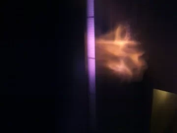

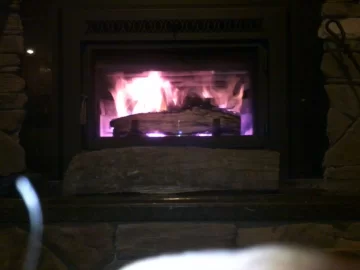

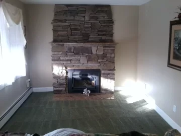

My buddy just put the big one in his house and the smaller one in his friends.Beautiful big glass! Puts out good heat. He had a vermont castings which he felt put out more heat do to the fact it stuck out more. Pics are a little dark of his, the one with no fire is the smaller model. [Hearth.com] Travis Industies[Hearth.com] Travis Industies[Hearth.com] Travis Industies
