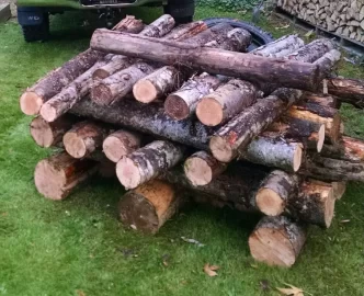

If you cut the small diameter logs/limbs into, say, 4' sections, exactly how would you stack 4' pieces? Assume no big power equipment is available. What should the stacks look like?

I've done that. Lay 3 pieces of poplar (junk) as large as you can handle spread every 3 ft., then lay your good lengths on top of that perpendicular. If you set everything between a few sturdy trees, you don't even need supports on the end of the pile.

Like said earlier put the popular down on the ground in the mud etc. then stack the good stuff on top, the more the better.

Putting poplar on the ground to protect the ash and walnut is brilliant, you should buy that man a beer.
