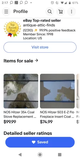

Is Craig still around? Might know where some are.
A little digging, I found some for sale:
