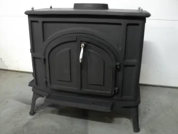

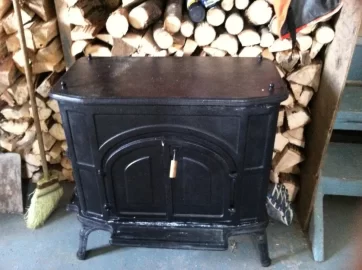

Looking for a stove for occasional burns in my old house. Would not be the primary source of heat. House is 2200sq. ft and old and drafty. Saw this Upland 207 for sale for under $300. Description is:
Upland model 207
Takes up to 26" Logs
7" Flue
31"wide x 18" deep x 30" tall
Has 2 adjustable secondary-burn heat baffles, and 2 internal rear baffles.
50,000 btu
All new gaskets, show-room condition.
Question: Good stove? Is this too big for just occasional use? I love the side door which none of the VC stoves I have looked at have.
  • [Hearth.com] Upland 207...Should I?
Nice find! It's a fine old stove. Should be ok for occasional use, just be sure the chimney is clean and safe to use. Install with the proper clearances for stove, piping and hearth and burn only seasoned, dry wood
It's quite a different design, simpler. You probably are not going to find a new (old) Resolute or Intrepid anytime soon. This is a real find. Contact @webbie for more details. He bought and ran the company!
Do you think it is better than a VC Resolute or Intrepid?
I think it is because it has a reverse burn design. You slide the baffles away from the side door (far right) so as the air comes in the side, the exhaust flow has to move towards the side door with the intake against normal flow. For this reason you don't keep adding fuel or build small fires. You fill it and let it burn down. If you want an open fireplace with screen in place, slide baffle plates to the sides so it is open in the center. Don't overheat or abuse it. The large rear panel is a single piece of cast iron that can crack with uneven heat. You can still get the baffles, but they aren't cheap.

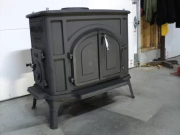

So I just found out the 207 is available and I perfect shape. Question...does this stove only have a top vent option or is there rear vent too.
Sent from my PURE XL using Tapatalk
Top or rear. If you Google Upland 207 "Images" you'll get pictures of both.
And the baffles actually close the opening down to 6.
