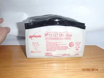

Many pellet folks appear to back up their power with computer type UPS units. They usually have several sealed batteries that are maintenance free in side the case. The unit I use on my office equipment is one of these style. Last week after coming back home to my house I smelled an odd odor in my home office. I traced it to an APC UPS. It was easy to trace as the unit was beeping and lights were flashing. I went to touch the units case and it was very hot to the touch. I quickly unplugged it and pulled the disconnect jumper from the back. I finally had a chance to open up the UPS this morning . The two battery cases were swelled up on the top and all four sides with the two batteries stuck together. In some spots the case had expanded as much as 1" It took me a bit to pry them out of the frame as they swelled into the gaps in the frame. I had a pair of spare batteries so I installed them and the UPS seems to be working correctly. No trace of battery acid.
There was no damage to the surroundings but I expect there could have been. These batteries were about time for replacement, but the last time I was given some front end warning during the automatic tests and shut it down when it indicated it had lost capacity. I was given no warning this time. It was working properly the day before with no beeps or warnings.
This UPS is known generally quality brand (APC smart UPS 1000).
I would suggest that if you do run a UPS that you probably keep it on a non combustible surface and definitely not cover it with anything.

Here is a photo of one of the batterys [Hearth.com] UPS batteries a cautionary tale
These types of SLA(Sealed lead acid), and AGM( absorbed glass mat) are heavily used in the alarm and emergency light industries. The suggested life is 4 years, I've seen them fail as early as 2 years when they aren't charged properly. I would recommend pulling the a/c cord at the beggining of the season and midway through for a half hour or so to make sure the batteries are actually in good condition. Most APC units I've had experience with didn't give a battery alarm until the batteries actually ruptured like yours.

They are sealed, when they start to fail heat is generated the heat softns the plastic and the gass build up swells the case. If it doesn't tear it will explode. These things should be inspected regularly.

They are Valve Regulated Lead Acid batteries. They do have a vent if pressure gets high enough. But have also been known to rupture due to overcharging/overheating.

It sounds as if the battery had a shorted cell and the charger thought it was just a battery in a low charge state. The problem is that many "dumb" battery charging circuits can't tell the difference. That leads to severe overcharging for the remaining cells in the battery. Any battery when overcharged produces hydrogen gas. Sealed batteries have a catalyst in them that recombines the hydrogen with oxygen up to a point. When the gas generation exceeds the capacity of the catalyst, the cell is supposed to vent so that it doesn't rupture.
Since none of these safety features ever gets tested, you don't know that they have failed until they don't provide the funtion they are designed to do.
By the way, charging batteries of any kind should always be on a non flamable surface.
