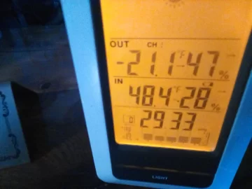

No backup. Two wood stoves for a 3000 sq ft farmhouse from the 1870's. PE Summit and Quad fire 4300. Last couple of weeks backup consists of not sleeping much. One spot where the pipes will freeze at a point so I will crack the faucets a bit. When we can afford it a backup will be added just not sure what.
