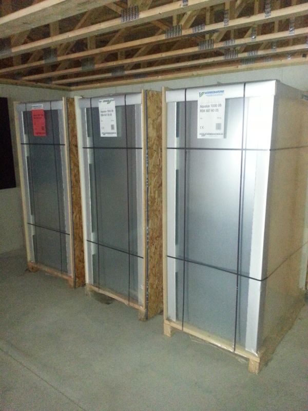

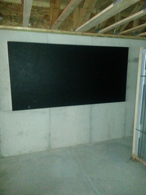

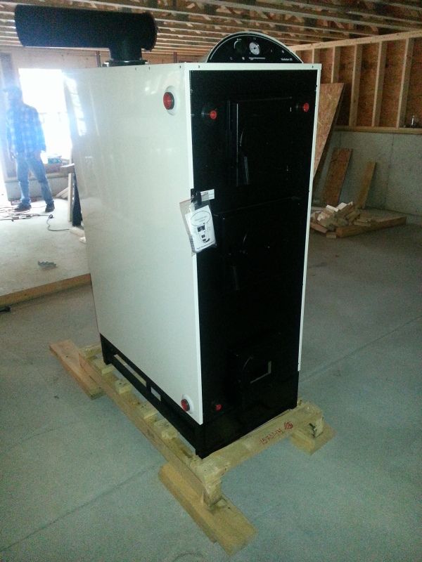

Here are a couple of pre-install pics
[Hearth.com] Varm Vedolux 55 Install

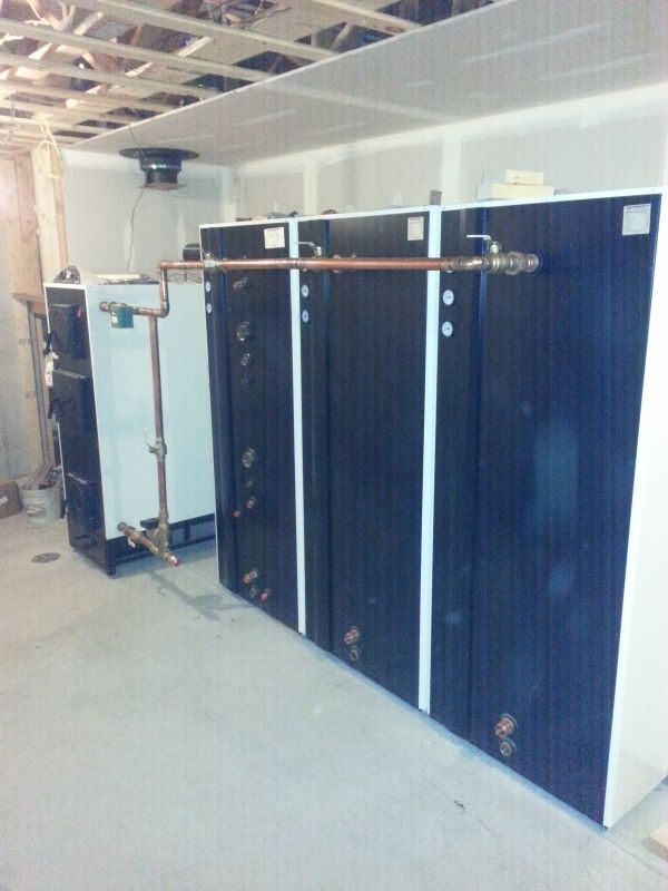

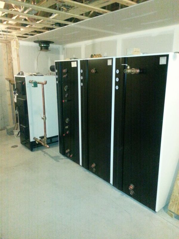

Finally started some piping!

Those tanks are about the only thing i can do because my boiler room is in the middle of my basement and it is all finished off i hope they work out well for him. So i have been running without storage because of the cost.
