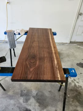

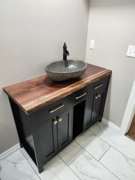

I used arm r seal and love it. It tell you exactly how to use it on the back of the can. You sand it twice with different grits of sandpaper and then you apply i believe 3 coats. Its a poly seal and its very water proof and durable. They have glossier ones but im not a fan of shiny wood but hey I would love to see your before and after pics.
