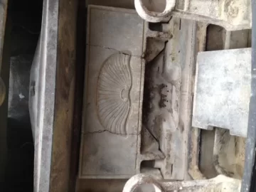

1st pic is looking down exhaust, It shows the top lip of refractory brick broken off.

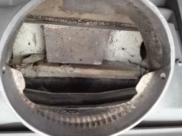

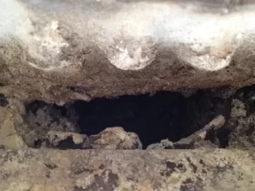

Last pic is looking up the hole in the bottom under the clam shell design in second pic. This is the hole right in the center of the second picture. Sticking my hand up there it is very thin, jagged and deteriorated.

I can't tell what pic two is showing, but the assembly isn't in that bad of shape. Unless I am missing something it looks very usable. The Everburn models were notoriously hit or miss in terms of locking in a temp. But, give it a go. Even if you need to by a new assembly in the next year or two, it's still cheaper than buying a new stove.
Yes, you would have been better off with another type of stove, but this one will work if your budget is tight.

Pic 2 is the port I guess all the combustion gases draw up when in everburn mode. In pic 3 there are 5 little air holes below that scallop design. This port is between the two, basically right in the middle of pic 3. This port is super corroded inside. Very thin and crumbly.

Also in case it isn't clear, pic 1 shows the top lip of refractory brick is broken off. It looks like someone tried to re-adhere it with nails and some tpe of cement that melted. 6-8" in the middle is detached and just sitting there.

I think you are exactly right in your concerns with the Encore. It might limp through the season, or maybe not. But considering would be in your family room with a hot fire and perhaps multiple people running it, I would pass. Sell it for the best you can.
