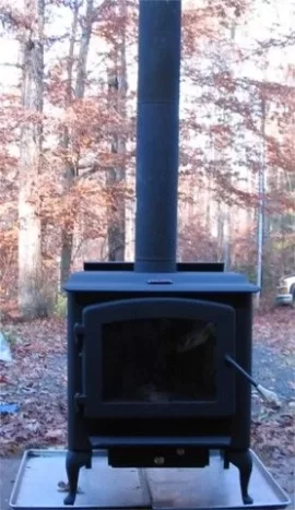

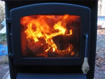

Well it is day two. . . Smell is less noxious and I think I am getting the hang of it. I had a hard time getting the stove going yesterday, and I believe it was that the wood I was using was not completely dry. It seems these stoves are much more sensitive to moisture in wood. Even today, I was hovering around 200 degrees for a while, then it started to roll got it up to 500. I just added a second set of logs and the temps are creeping back up and there is a beautiful secondary fire burning (or whatever it is called). So far so good! It is about 6 degrees today. I will be interested to see how things go when it is 30+ out.
