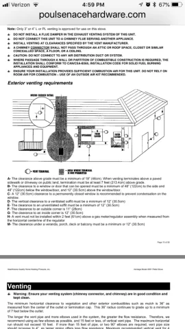

in thinking about a pellet install in basement, I’m now think that a through the wall install would be the way to go. I was looking through a Quadra fire manual and it said to not vent under a vented soffit. Is there any acceptable distance below these soffits that the venting can be? 5 feet, 10 feet, 20 feet?
The Hearthstone Heritage Manual page 15 states 12” but you should go by the manual for your stove.
(broken link removed to http://poulsenacehardware.com/wp-content/uploads/2017/10/Heritage8091Manual.pdf)

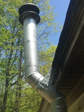

From my experience it also depends upon the wind blowing back on the house. In 2 cases I had to put in 2 45s and then go 2 feet above the roof line. This is the very best solution with no smoke making the siding all black! !!!
Note: Nice bracket to hold vent securely to house.
Also use 4” diameter venting if you can. It performs better, does not leak as easily (less pressure on the seams!) and much easier to keep clean!

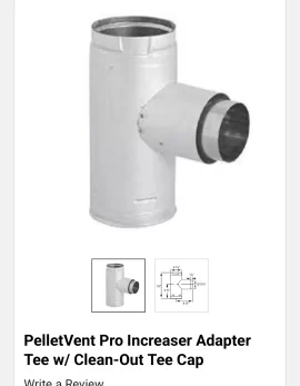

My quadra fire santa fe has a 3” outlet. Can I transition to 4” at the T claenout? I have a similar installation plan to get above my vented soffit. Soffit is only 10”.
Yes - It is called an Increaser adapter cleanout Tee
Description​
Use for a 90° offset. Attaches directly to appliance as an adapter. Converts a 3” appliance to a 4” PelletVent Pro system. One piece unit incorporates removable twist-lock Clean-Out Tee Cap.
PellentVent Pro Info:
PelletVent Pro is a versatile venting system specifically designed for stoves and inserts that burn wood pellets and oil fuel. It can also vent biofuel products like corn, switchgrass, cherry pits, soybeans, coffee husks, sunflower hulls, walnut shells, wheat, and more. This system is rated for continuous use with flue
