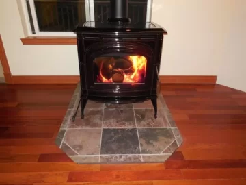

If you want both catalytic and cast iron, consider Blaze King:
[Hearth.com] Vermont casting or Woodstock
