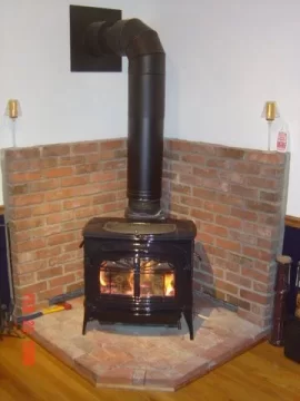

Thanks for the post Shaun. It's good to hear the positive side of the stove as well. Can we assume your Encore is the non-cat model? Can you post some pictures of that beauty?

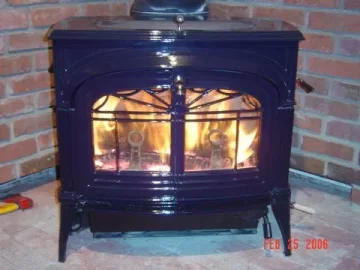

Here are a couple of shots of the Encore NC in action.
