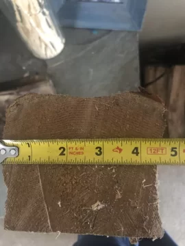

This is pretty much what I shoot for when processing my firewood. The 4-5 inch piece is typically the largest split I will use when stuffing the box full. The trick to loading all the way up to the GT is use mostly square splits and when you get to the top of the andirons you need a split long enough to span the entire opening so nothing can roll into the glass.
