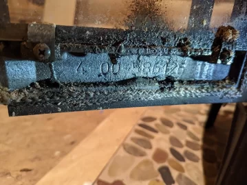

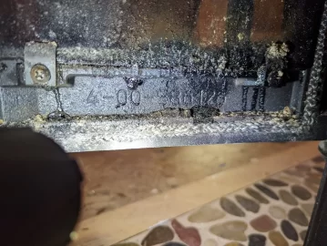

Ok have to do this from phone because computer browser isn't letting me attach for some reason.
So I took a vid this weekend. The top side areas are clear in this video but normally not and the middle is darker than normal I feel. Overall this isn't a bad view at all which is why I grabbed the video and this would be on the plus side of my experience with glass soot.
Also attaching picture of door soot before firing up the stove last weekend. Does this door stuff burn off when the next fire gets going?
Yes I imagine burning only on the weekends and letting this go out every week will add to my creosote. PXL_20221015_001142227.jpg PXL_20221015_000857178.jpg

This (sticky and running (liquid) creosote) is what I see when I go "full black box mode" on my (cat) stove (with the cat cleaning it up before it goes in the chimney).
If the stove burned like that video (flames) all the time, I think you have air leaks at the door or windows. Because that is not a "turned down smoldering"-fire which would (also) result in running creosote.
Air leaks let in cold air, cooling down combustion, and hence making that combustion incomplete --> creosote.
To the OP: if you have much draft, and are not smoldering, but end up with black windows (and have not turned down the stove), I think the same is present. You can have both (good/too much) draft that makes the stove less controllable AND black windows - if air leaks are present.
Hence, the dollar bill test (test all around the door), the solidity of the window in its frame, and the key damper in the flue that begreen suggested would be the first things I would do.

that video I took was with the control all the way open. It dances gently when I turn it down, and is very hard to see when turned down all the way. I have no flames with a full wood box, that video it's probably only 1/3 full.

I did that last year. I need to do it after the gasket replacement. Today it ran wild again, whistling all the way to hot hot hot. Im close to calling in a technitian to take a look. air is seeping in to the burn chamber, likely through the damper opening as the new gasket fixed it temporarily but seems to still be a gap somewhere. Wonder if I need a new damper. the stove is only 2.5 seasons used. Waiting for it to cool to take a look.
Kevin Weis
Mar 3, 2018
1,163
Union Bridge, Md
I'm late to the party here but I have a Intrepid flexburn with about 2 years experience running it. I have the same issues with the glass getting dirty quickly. jstol I see your post where you vacuumed two small holes in the burn plate that took care of this issue. What burn plate are you referring too? When I bought the Intrepid was told by dealer right off not to expect the glass to stay clean. Maybe this is my problem as well??? The Damper gasket is a bear to replace correctly. The track needs to be perfectly clean and the damper closed on it to hold it in place till the gasket cement can dry. Otherwise the damper would need to be removed to facilitate cleaning and gasket replacement. Fun stuff. I attribute the dirty glass issue to the design of the airflow within the stove.
