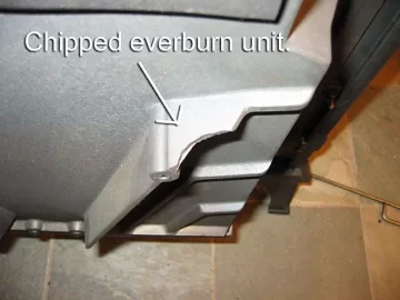

Tradergrodo you asked for pictures and I feel that one (which I had sent to the dealer at the end of last winter along with others) is the one most relevant to my problems. I can only suspect though. It is of the chip out of the back of the stove. The "inspection team" said that it could have happened when I laid the stove on its back to put the legs on. I did not. I followed the instructions to the letter. That is the way the stove came out of the crate. I only noticed it after messing around with all that was going wrong. And although the dealer said, "the chip was not a problem", (which might be true) how it got there and what it might have done to the delicate nature of this stove quite possibly could be. Here is a pic. It should never have left the factory.

I don't see a problem with the chip (operationally)......which may not help much, but take it for what it is worth....those ribs seem overbuilt....heck, if I was at the factory, I'd have ground this one smooth and the other side to match......

(I assume this is the exposed rear of the stove?)
It definitely could have happened (and in fact probably did happen) after it left the factory...after all, castings are cheap (to them) and they have no reason to pass something like this through, as opposed to throwing it back in the pot.
I can assure you that the dealer was never supposed to assume any "pass-off" of such responsibility....and I was (and my store still is) a VC dealer since 1985. It's fine for manufacturers to have inside agreements with dealers about what the factory expectations are, but that stuff is not supposed to be public or a reason to deny or make excuses.
Your stove may have some problems, but that chipped corner of that casting isn't one of them. Rick

I know the chip has nothing to do with how the stove performs. My point was... what did it take to make that sort of damage? And what other damage to the stove could have occured as a result? I don't know. All I do know, is that it was shipped from the factory that way. It was let through. Unless of course, the dealer had the stove out of the crate, broke it, put it back in the crate, while waiting for a likely victim (like myself) to come along and buy it cash and carry. You see, I transported and installed it to save myself some money. That just leaves it at my word against a figment of my imagination. The chipped piece was not in the crate.
Tradergordo. Sorry you had to go through my diatribe. So far you have given me the most hope in keeping warm this winter. The new dealer is coming to have a look at it when I get the WETT inspection done. I will see what he can do for me. And although I have not done it yet, I will go through all your stuff to learn more about my stove and most likely do the work myself. Because as far as I can see, there ain't no warranty on this beast. Can you believe it though? I bought this thing three months before CFM went bankrupt and the fun began. Someone has a sick sense of humor and all I can say is, it's a good thing I still have mine.
A forklift fork could have done it - or it could have been packed that way at the factory - QC is usually better than that, though...but maybe it was getting near the end and they slacked off....
