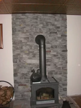

Very confused..getting frustrated
Is that a full liner or just a chimney cap? There's a lot of mass in a brick chimney to heat before you get roaring, so if you're just burning once a night its going to be tough to really get it sucking good air.
Looking good Whitman. Woodstock sells a stove pipe wall trim collar that will hide that reducer where it goes into the wall and give it a more finished look.
So why does Woodstock say not to use fatwoods - I have been using them in my new Keystone and didnt see any issues. I also have not had any problems getting stove up to temps or any real problems with dirty glass - except right at the begiining.
Basically for now I have been starting the fire with some kindling and one ball of paper and maybe two fatwoods. Let it build up a bed of coals - with door open for the first couple minutes- then about a 30 to 40 minute burn with door closed and damper around 2 to 3. Add maybe two small splits and then wait anothet 15 minutes or so and the stove is up to temps. Engage cat and watch flue temp drop and stove temp rise. After a hour or so put in two or three bigger splits - let it burn for 10 minutes or so to get temp back up and dry out wood - then engage cat and let it go for awhile. Have been burning 24/7 the past few days.
Its been heating our whole house which is two floors and 110 years old - maintains about 70 degrees in upstairs
Again my concern is the fatwoods and why they are no good for my keystone - heres a pic of my setup

I never heard that about Fatwoods, they are just pitchy Pine sticks right? I would think any kind of firestarter would be ok in a cat stove since you start up in the bypass mode for 15-45 minutes which gives plenty of time for all the cat nasties to burn up before passing through the cat?

Right on btuser, this has been asked also by BeGreen and has been the best damn questions in this thread. This one needs an answer but has been ignored. Set up looks good but whats beyond the wall/brick?

It is just a chimney cap. So it sounds like this may be the root of my problem. I can not afford a liner at this time, so any suggestions?

What is the inside diameter of your flue tiles? 10" square is the max for your stove but 6-8" is best. It looks like an inside chimney, so it may work fine as is without a new liner. You might have to give it a little more air after you engage the cat and wait a little longer before turning it down to a low burn. Just keep playing with it, it's early yet, a little trial and error and you should be fine.
The flue is the engine that drives the stove. When it is warm outside draft can be weak, especially with a shorter flue. We need to know more about this chimney and how the stove is connected to this chimney.
Still need a good description of the chimney. Without that, we are just guessing.

Wow . . . I really like the look of this hearth and set up.

+1 I'm with you Jake. Don't miss the ceiling--it looks like copper? Nice.
hey do tell more about this 'reducer'. is it a woodstock thing or what? am i seeing a larger pipe going into a smaller diameter thimble? if so, that right there could restrict draft pretty good eh?

There is a reducer going into a 6 inch thimble…chimney lined with clay tiles. Not sure of dimensions.
