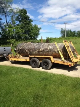

    She's a beauty! Pick up a used 1000 gallon propane tank this weekend. The paint is flaking off pretty bad. Thinking of stripping off the lose pieces with a compressor and stripping wheel. Anyone have a easier way?

    After a failed sand blasting attempt with some poor equipment, I just pressure washed mine, then took a wire wheel to the bad spots. Another half hour with a can of rust paint and a roller and I had some sweet looking tanks. ;)

    If you are going to spray foam your tank, do it before you place it next to a wall and frame it in. I found out too late you need some clearance to spray on the foam. I removed the old paint from my 1000 gallon tank with a disk sander; worked fine.
