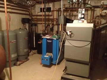

vigas boiler
I like it.
You have me way beat on Y strainers and dirt separator. Of course... My system took out a circ on my DHW loop. :(

Do you WANT heat in that area. I quickly starting wrapping the heck out of my exposed copper. You won't believe how much 190 degree pipes will throw. I'm pretty sure I used (broken link removed to http://www.zorrotools.com). Lots of different kinds of pipe insulation. I did a little at a time.. starting with the out leg of wood boiler.. figuring to wrap hottest stuff first.
You're gonna heat up your buderus jacket to same temp as storage and tanks? probably not a big deal, as you won't have much loss at all because you went power vent on that, right?

I am going to insulate all the pipes and tank once she's up and running. I plumbed it myself so I wouldn't be surprised if there is a leak or two or three.

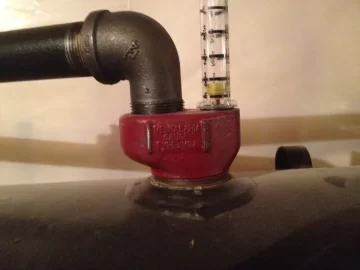

  • [Hearth.com] vigas boiler
What is that thingy??? Some kind of bank statment-o-meter? Looks like your outta funds :confused:
