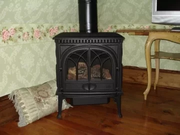

i think the thread said...they are really a fast hot burning stove because of the nature of soapstone.
heres the answer for this guy:)
a gas stove!

well now im thinking the jotul 118 might be the one for me
