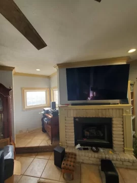

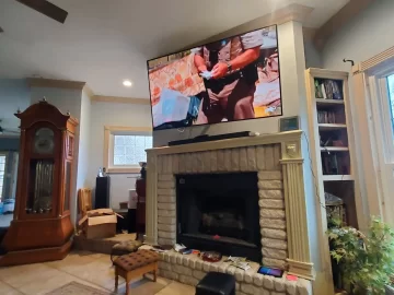

Guys, Tn

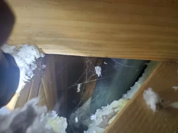

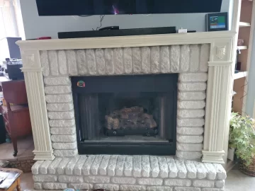

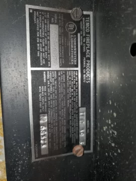

I recently purchased this home with the above mentioned insert. It has a dual burner gas log set in it now. I have read online the install information on this unit and it says you can burn wood in it (which made me believe the construction around it would allow me to remove and replace with a wood burning insert.) I moved from a home with a Jotul wood stove in it. My wife wants to demo the whole corner and replace with sheetrock then install a wood stove in the alcove to the left of the current situation. I am leanng towards an Ironstrike Montlake 230 or a Pacific Energy Alderlea 75 which dimensionally would fit. After reading some threads here I now have concerns that I can't do it because of the zero clearance and combustibles in the attic. I have enclosed pictures of the front of the unit, the mfg tag, views from up in the atttic and outside . Any help would be greatly appreciated!

Yeah you can't install an insert in there

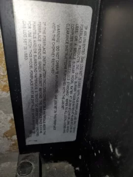

So there is nothing I can do to correct the inside of this chimney/firebox area to make it safe? is it a dimensional clearance issue?
WARNING: THIS FIREPLACE IS NOT INTENDED TOBE USED WITH ANY COMPONENTS OTHER THANTHOSE SPECIFIED IN THIS MANUAL (i.e.FIREPLACEINSERTS, BLOWERS, GLASS DOOR EXTENSIONS,HEAT CIRCULATORS).COULD RESULT IN A SERIOUS FIRE HAZARD
This is directly from the manual for your fireplace

And you absolutely cannot just pull out that fireplace and put an insert in its place. It would have to be replaced with a new high efficiency fireplace and chimney

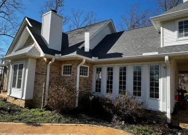

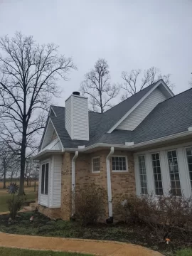

An update for this Tempco replacement:

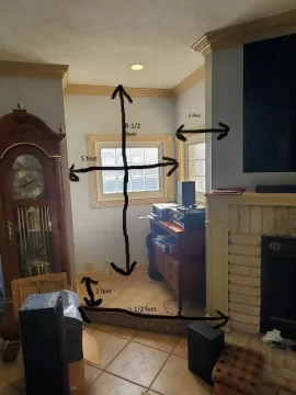

I have decided to go with a free standing wood stove (exact brand still undecided perhaps a Pacific Energy or Hearthstone.) I called in a stove contractor and we discussed removing the interior chase and making that corner of the room a 90 degree corner wall and moving the stove placement over to the left where there is currently a small alcove. I have attached pictures showing the dimensions of the alcove.
The attic space between the inside ceiling and roof is approx. 2 feet.
The contractor suggested bringing the flue (double wall insulated pipe) up and thru where I show the outside of the house and have a white line representing it.
I have major concerns for this placement as from what Ive read it violates the 10-2 rule. He told me that no more than one pipe connection cannot be done above the roofline so we are looking at: 8-1/2 feet of interior height total (stove included) and 2 feet of attic then thru the roof. I am thinking that about 3 feet of pipe would come thru the roof with another section attached would bring the outside chimney pipe to 6 feet tall. Looking at the outside picture there is just no clearance within the 10 foot requirement yet alone 2 foot above any ridgeline .
The outside view shows 2 small windows that reflect the interior alcove location.
Any suggestions or thoughts? Do you need more dimensions to comment?

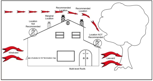

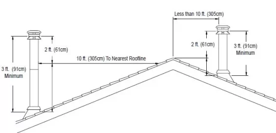

Should work as long as the alcove clearance requirements for the stove of choice are met or exceeded. The chimney will need to be higher to meet the 10-3-2 rule. Do you know if this is on the windward or leeward side of the house for the prevailing winter winds?
I'm trying to orient myself. Are the windows behind the fireplace fake?
