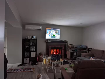

I have a Sears "Prefab built in mobile home fireplace" in my living room (model 155.847201, couldn't find online anymore). We came into a lot of wood from some trees that were professionally taken down, and we've been slowly splitting and stacking it ourselves. We couldn't stomach the $600/month oil bill we had last year, and it will only get worse. We had intentions of putting in a woodstove insert, but after starting to look for quotes, this doesn't seem like an option. No installer will touch a prefab with an insert. What is the best option?
We could potentilaly do a freestanding wood stove, but i'm not sure what kind work would have to be done to the chimney to ensure it's capable of the heat from the woodstove. I don't want a woodstove because our living room is already small, we don't have the space, or even a hearth. Everything on the inside of the house is fake mantle/brick. I would want to redo all of that with stone or tile facing.
Could we demo the existing prefab and install an insert? Or would it be too costly to essentially install a new masonry fireplace just to install an insert? I want an insert for space concerns. The prefab is through our garage, so very accessible on the backside.
Currently this Prefab unit does not give off much heat at all. It kept our living room at about 65F during the dead of winter when we ran out of oil. We have to keep the doors wide open if we want any heat from it, which is a hazard with logs falling out.
I'm at a loss of what to do. All the intallers want us to tell them what we want, they don't want to offer advice or best options for our situation. Any advice or ideas would be appreciated! Thank you. (see attached picture of living room and fireplace)

Your options are a new high efficiency prefab unit with new chimney.
Tear out the prefab and install a freestanding stove with new chimney.
Or tear it out build a masonry fireplace then install an insert.
The cheapest option is most likely a freestanding stove. Followed by a new prefab. Then a fireplace and insert.

If space is constrained then a complete removal of the existing Sears ZC and creation of an alcove in that space for a freestanding stove is another option. The TV would need to be moved as the alcove would be open to the ceiling. It is possible to build an alcove that is 100% non-combustible, so that the stove sat inside with the tv above, but that would require careful planning and stove selection.
