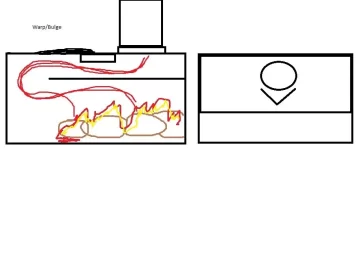

A couple of the other Quadrafire 4100I owners were talking about the same thing a few weeks ago. Myself being one of them has this exact thing at the top of my unit, which flexes during burning cycles. To the same degree described. When cold, it goes away to maybe an 1/8" or less curve to what used to be a flat top portion of the stove. When firing, it flexs about 1/4" or so. I'm no steel expert but the clinking everytime everyone fires up the stove is the steel flexing correct? So its just a part of burning from what I gather and has caused no harm so far. Check every couple of weeks as I burn 24/7 and would consider by use on the harder side never going more than 5-6 hours without a reload. 2.5 years of that and she's still trucking. I think those Rutland's are great as a guideline but not a true reflection of stove temp at the real areas. At least for inserts since we can't get stack.
Attached is my self portrait of the reason why it bulges in my mind... the airflow. And on my stove, I've got this little "tri-angular shield" before the exhaust exit, seen on the pic to the right which is a top view.
We've been toasty warm with no signs of failure at the welds or metal. I also keep the blower on as much as I can and that seems to help keep the stove at a consistent outside wall temp to contain the flexing. Tho I still don't like it!

Great diagram! That shows exactly what mine is doing as well.... 4100i.
Mine glows and as described in a previous post, it's always the area right in front of where the liner connects to the stove (the area right where the air flow from the blower is blocked by the liner). The top of the stove does "flex" and it goes back down when it cools down. I can't see a way around it. It has to get hot to get the secondaries. I think it's normal for this stove.
Dollars to doughnuts those stoves have a "flame impingement" plate welded in right where the glow is occurring. Its job is to keep flames from going up the pipe and the gases bang into it and have to go around it. Therefore is gets mighty hot. Especially with a new load where often flames will curl up over the top of the baffle.
