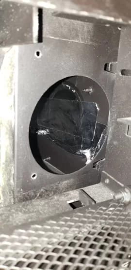

Putting a damper is probably out and putting a damper on fresh air intake is out as well. unless I tear apart all the stone work. Which if I do that I'm pulling the whole unit out and getting rid of it. I will try all tubes tonight after work as suggested. The washer just fit in by friction.

I tried 2 tubes could not get the third tube out so I stopped. The 2 didn't help at all. So I took some other advice to try restricting the fresh air. So I used aluminum foil tape and covered more than 50% and was still able to close the fresh air lever all the way back. But it still did not extend the burn times, and still got as hot as it did before. May try one more piece of aluminum foil tape to restrict it even more.

Where are you applying the foil tape on the stove? Pics preferred :-).

Where are you applying the foil tape on the stove? Pics preferred :).

  • [Hearth.com] Washers in re-burn tubes

Interesting. Thanks! There is no similar opening in my insert, but as yours is a fireplace, that isn't a surprise
Literally only about a 1/2 inch opening on top of fresh air intake hole. And I can still close the fresh air damper all the way closed
Is that foil tape on the stove or where the Outside air intake mounts to the stove? You want it on the stove side od the intake.
