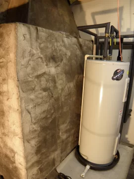

One of the peculiarities of this old house is that we have a water heater located in an unheated attic space, feeding just the sink and shower in one bathroom on our fourth floor. This has been used solely for guests and emergencies the last dozen years, although with kids now into their teen years, it's probably not long before one of them chooses to move up there to the little suite for a little more privacy and autonomy.
The water heater is about 15 years old, and being above several floors of original old plaster we don't want damaged, I'm thinking it'd make more sense to replace it now, before it leaks. It was also (stupidly) installed in a shallow pan, which makes it impossible to connect any hose to the drain cock. Careless prior owners / plumbers.
Fuel available is electric or propane, although venting requirements may favor electric. I'm sort of interested in options for on-demand, given it's low-usage and dedicated to only one bathroom immediately on the adjacent wall, but I have concerns about it freezing. We get sub-zero here, not frequently, but maybe 1 - 3 evenings per year. We can have long stretches of single digits, and I suspect that attic is well below freezing at these times. The water heater keeps the insulating piping warm enough that this is no concern, but do on-demand systems have freeze protection? Do they have to cycle all night to keep from freezing on cold nights? If so, that might also favor electric.

Here's a photo of the setup I happened to have handy. Chimney is to the left (with signatures of the builders and the 1770's inhabitants of this house scratched into the wet stucco), and the bathroom wall is behind the water heater, in this view. Lots of exposed plumbing, which could be all cut out and re-done either inside the wall, or within a secondary chase.

That pan under the tank is code in most places except they should not have put that pipe on it.. If it were me i would be getting rid of the upstairs tank. No matter how carful you are and how well you think you are prepared if things go bad all that water has to go somewhere and that is down.. the expense of moving it now could save you huge if you ever had a unforceen failure. Not to mention i could not sleep at night knowing i had hot water above my head..LOL..
15 yrs. on the water heater is definitely pushing it. Is that really a 60-gallon water heater? For one bathroom a 20-gallon unit with quick recovery would suffice. A smaller unit may also stop guests and daughters from taking forever showers.

1. Proper access to drain cock.
2. Install over drip pan (likely larger than this one), with flood sensor installed.
3. Install on unions (maybe even PEX) for easier future replacement.
4. Write a date on the thing, set a calendar reminder, and just replace it every 10 years.
