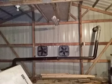

I found this yesterday looking up wood stove for sale on Facebook market place.

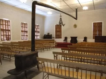

Here's one from the Center Baptist Church in Thorndike . . . they have one service a year in the Fall so the stove is not used that often.
Keep an eye on that guy, he is going to be selling a new wood stove every year ("...and THIS BRAND sucks too, just like the last ten!!!!")
That's an old Bangor made stove isn't it? I bet it puts out some heat ran wide open.

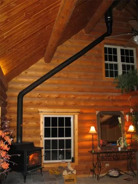

This install was posted several years back. At least it had enough pitch to stay fairly clean according to the poster.
Oh wow, that's almost identical to my house, but I left my stove in the center(ish) of the wall to keep any bends out of the stack (plus it's a little more in the center of the room for even heating)... they must have really wanted it in the corner.
