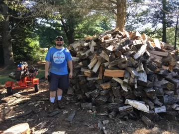

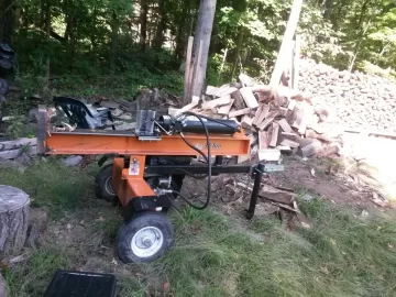

I've always used a log splitter, just got a new one earlier this year and love it.This one is well build and handles itself pretty good, the Honda Motor is really nice and good on gas compared to the other one I used with the briggs engine. Got this one at Northern tools for $1700

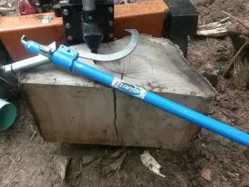

Or you can spend much less than 1/3 the price and do it the easier way with a tilting splitter while you do most of your work sitting on a round. Notice the all important chair next to the round being split.
(County Line 22 ton made by Speeco new for around $800)
I have the same splitter and love it. Only split eight cords with it so far with no problems
