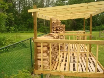

The six post are set on cement post blocks and the joists are 6" treated deck wood. The divider and side walls are spaced 12" apart and are 2x4's. The front of the shed is 8' and the back is 7'. The rafters are 24" apart. The pallets are set on the ground. I hope the pics help.

Seems like the key is to set the pallets on the ground in the middle and not to have the wood supported by the deck. Just too much weight. The pictures help a lot. There's my spring project. Copying your wood shed exactly haha.
