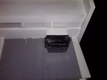

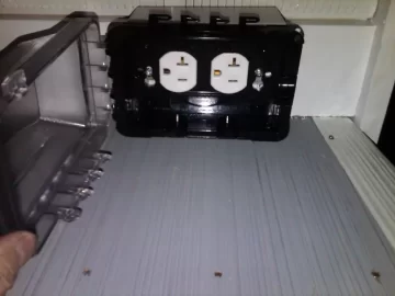

Since my shed needed AC, I dug the trench and wired some outlets. I put one under the soffit in front and one back on a 3 way switch. See pics One switch is in the house and the other is in the shed.
The AC outlet cover is a plastic dome, so I can plug in the rope light and close the cover.
But I want to se your lights before I buy the rope light. Thanks

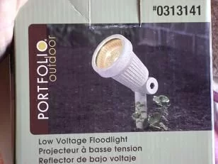

I have some daytime pix. I will do some night pix.Mostly from Home Depot, and Lowe's

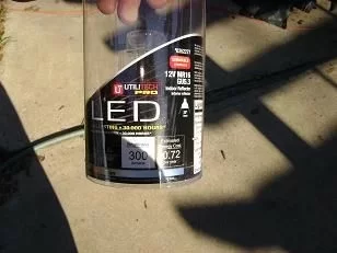

To get more light you can use bigger transformer. An extra $100 or use LED lights. Still an extra $100 but less energy.
Not a direct relationship because the transformer uses some power even with very little attached to it
UtiliTech LED 12 v 300 lumens Good
Sylvania has same thing, same shape, but 30% less light from spec.
Utilitech used normal measurements. Sylvania seems to use EPA mileage measurement methods.
Hint for any light. Get then high. When you are walking toward light it will not be in your eyes as much.
A little bit of foil tape or sheet metal visor can make a shield to prevent the light from going into the neighbors windows.

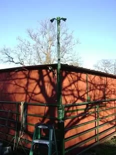

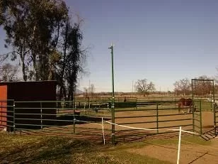

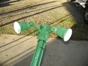

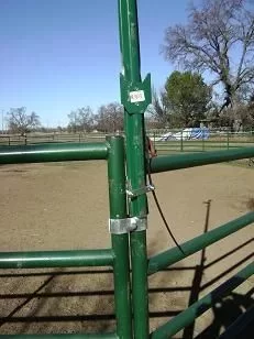

Details for pix.
Light is clamped (will be bolted) onto fence post, which is clamped to coral pipe.
U shaped fence post clamps to round pipe nicely.
One pix shows Transformer, Remote Control, and Clicker.
Wire will go under house through vent behind transformer and come out on the other side of the steps.
Clicker stays in house near back door.

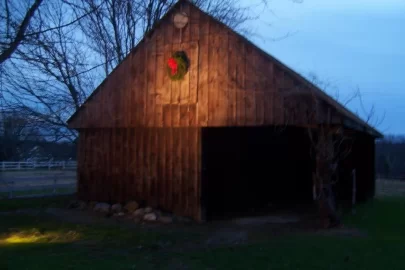

Pix below.
Face of outdoor junction box works well for mounting.
Wood shed pix is dimmed to simulate what two 12v lights will look like at about 7 feet high.
Notice original light under roof corner on horse shed. It is at about 7 feet. Too low and in your face.
Notice 2 lights above at about 10 feet. Much more pleasant.
The corral light is brighter than the picture shows. It is one light at about 10 feet with a diffuser to spread it out.

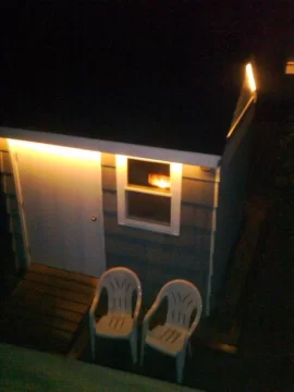

Finally got my lights in!
https://www.hearth.com/talk/threads/shed-outdoor-lighting-is-finally-in-see-pics.85261/#post-1096596
Pic below shows new lights and warm fire in hearth thru window in shed!
I put in quarter round molding under the facia board to hide the lights in the front and back. Then when building the shed we added wood behind the rake boards to the peak creating a 0.65 inch slot for the side ropes. Then the roof was shingled so the side slot is custom built-in!
Also have 2 three way light switches, one in the shed and one in the house so the outdoor shed lights can be turned on or off at either location!

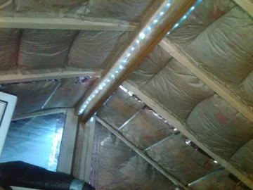

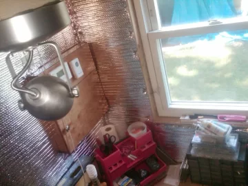

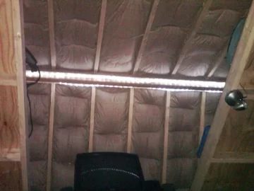

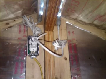

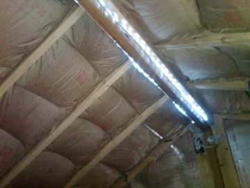

Hello
Well I finally got some inside lights!
Two LED cool white 10 foot rope lights from Target.com for $11.99 each ((broken link removed to http://www.target.com/p/philips-9-white-led-rope-lights/-/A-13506477)) and an LED spot light from Home Depot for $24.95
These LED rope lights have bulbs every 2 inches and are not nearly as bright as the soft white rope on the outside where the bulbs are spaced every inch apart. However the lighting is enough to see what is up in the loft and does not make glare on the TV when it is on. The spot is great for lighting up the work table area nice and bright although the picture does do justice on the brightness. All lights are plugged into a switched outlet connected to the interior shed light switch!
See pics below
