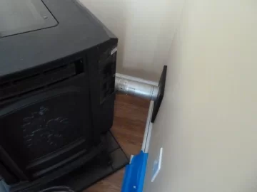

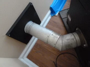

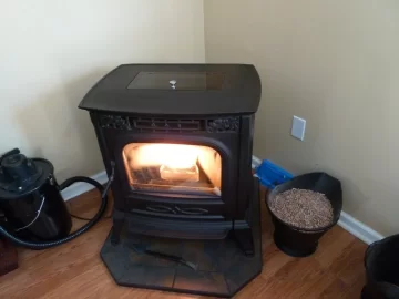

have to move my harman XXV out from the wall further.didn't know i had to clean a fines box and the blower fan,the installer never said anything,so,i had him put it 12 inches from the wall.well at 6'3" and 300lbs i cannot fit or have any room to do this.anyhow,going to add a 12" pipe to space it out from the wall.what silicone sealer do i want to use on the pipes?i see rutland makes a 600 degree black and red?is color the only difference?i also see alot of 500 degree silicones,is 500 enough protection?input always appreciated

another question:the pipe the installer used is made by intertek.i don't see this type anywhere.are these all the same?if i need a 12'' extension piece can i just buy a duraflame brand from my local homedepo?i am assuming you don't cut this stuff you have to buy it to size?here's a pic of how they set it up

Each company is different so the pipes aren't interchangeable. Best is to get the extension from the same company as your own pipe. Google Intertek and 3 inch pellet stove pipe.
You have to use the same manufacturer. No pipes interchange so it's find the same or replace them all.

Remember that if your getting over 450F your going to be in bigger trouble with wood starting to combust.
Another tip is don't have a joint inside the wall thimble.
Hearth pad is a bit skimpy as well.........
