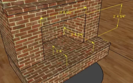

There is a smoke dragon inefficient wood stove in our relatives New Hampshire hearth now. There is talk of replacing it. Any suggestions on what might fit - either an insert or a woodstove?

Looks like several inserts would fit. How big is the house? How large a room/area is the fireplace in and how open is the floorplan?

You might be able to put a free stander there too.
I think that's the height in the back of the opening.
