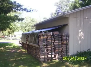

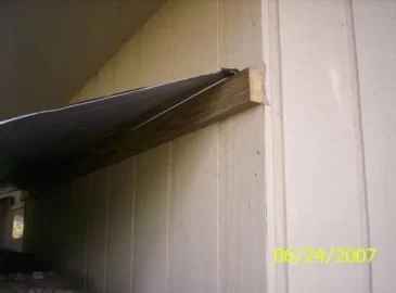

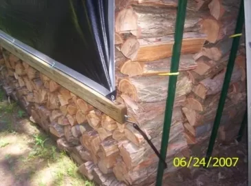

Like this? This makes it easy to cover or uncover. 2x4's, connected to heavy duty black tarps with eye hooks. If I see a soaker on the way I roll the tarps over the piles. Otherwise I leave them rolled up til fall.
