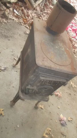

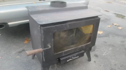

We have a tiny fireplace that we wanted to put a small wood stove into. Our choices were limited because of the size. Wood stove will be mainly used for heating our living room, we do not have a open floor plan. I bought a Reginald 101 (similar to the Jotul) because of the size. Then i was given a Trailblazer 1700. The wife and kids cant stand the Reginald looks. My only issue is that the Trailblazer has some weird small crack on both sides where there is some tubes with tiny holes in them welded to the interior. The people it came from used it for years here and there. Would it still be safe to use?
Which would put out the better heat? Living room is 12X20.
Im completely new to Wood Stoves, thank

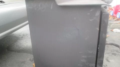

the trailblazer is scrap with a crack in the side it should not be used and i think it is not worth trying to fix it the other one might be fine cant tell really
Neither. Sorry, but I would not install either of those in my home.

Welcome to the forums. The Reginald, if not cracked or otherwise damaged, should be ok to throw some heat. As you are new to stoves, consider also that a safe flue/chimney and hearth (with proper clearances) is just as important as a sound stove. You need to make sure you properly vent whatever stove you use into a safe chimney system, with no combustibles (including mantle) too close, and are using dry wood, or else you run the risk of a house fire, chimney fire, CO poisoning, etc. Just a reminder, more homework to do than getting an online opinion of those two stoves!
Edit: that includes checking with your insurance agent, if you want to be assured of coverage.
Thank you. We have 3 cords of wood that has been drying for 3 years underneath our porch. I use it to make maple syrup. This was really on a budget stove for an emergency situation. I wish i had thousands of dollars for a new stove, but with 4 months left in our present house i cant justify spending that kind of money. Our next house we will plan better to have something that will last a long time. Our chimney was re-built 3 years ago and we have used it maybe 10 times. I do plan to have a chimney person install the stove up to code and it will need to be inspected. Can a welder weld up a crack like that to get us by or would that be a real fire hazard as i have young kids. Like i said this would be primarly used as emergency daily and occasionaly on the weekends.
The cracked stove is a no go at all.
The other stove reginald if it was in good burning order with no cracks could potentially be used but there is so much more to this than throwing a stove in the fireplace and calling it good.
A welder could absolutely repair those cracks. They might grind it down to look pretty, but a good bead of weld would seal that right up. I would get the cracked stove repaired since it seems much larger. Normally I would say to get away from both of these stoves, but since this is for emergency heat, either of these old stoves is better than nothing.
If you can find a local welder who will do it, that would be my choice.
