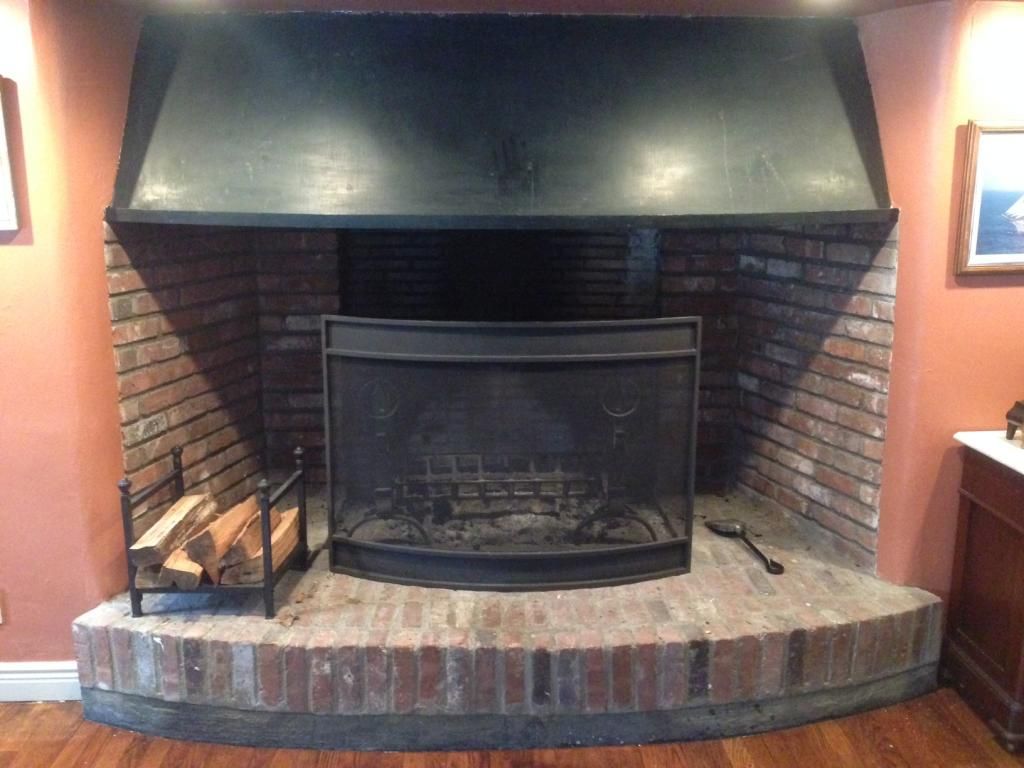

Looking for some stove suggestions to place in this large fireplace, not an insert due to the size of it, but a large stove with large glass viewing area and blower to use on occasion (not a full time burner).

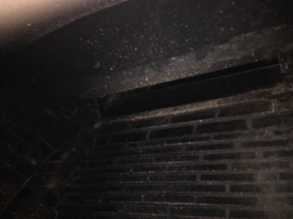

This fireplace never drafts very well, so it is rarely used since the room gets a little smoky, I think the hearth is too big, requiring too much air flow to pull the smoke up. A stove in there would solve this, actually heat while it's on, require less wood, and be safer.
I figure a good size stove with blower would sit in the hearth, run a solid black tube up a few feet, then go to flex stainless up the chimney.
Here are some pics. Let me know what you think. BTW, it's in an open floor plan, first floor with about 2,200 sq.ft and stairs on the opposite wall to second floor. Any suggestions would be appreciated, as well as stove suggestions.

Yowza!- I was reading your post and thought, "I can't believe this guy says large fireplace but does not give the dimensions." Then I saw the picture! You could park a Ford F-150 in there. The AWD model....

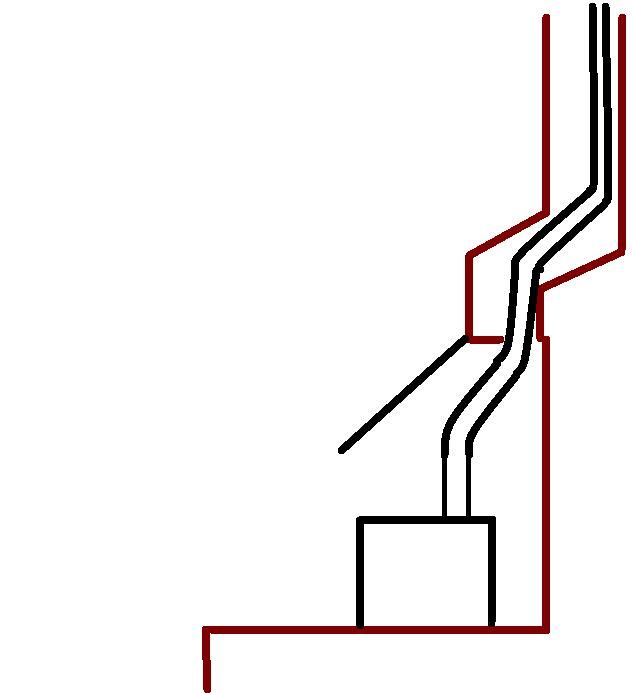

I wasn't referring to the vertical space, but rather to the location of the damper plate in relation to where the stove will have to sit. Is there going to be enough room in the back?
The damper plate is all the way at the back of the fireplace. The flue up the chimney will be flex stainless, should be able to flex it forward and down to meet the pipe sticking straight out the top of the stove even if it's forward a foot or so. Please correct me if I am wrong.
EDIT:
Here is a side view of what I was thinking. Rigid pipe up about 2' out of the top of the stove (you can see it from room), then stainless flex the rest of the way up.
EDIT:
[Hearth.com] Which wood stove for LARGE fireplace
Looks like it should work fine. I would maybe do a 45 off the solid pipe to avoid any hard angles for the liner. I think that setup is going to look very nice when you're done, good luck!

Good Lord! That is a fantastic fireplace! I have never seen a fireplace built like that. It looks good.
I need to come over and take some measurements, but, I bet the reason it smokes is because the firplace opening is too large, relative to the size of the flue.
The area of the flue needs to be about 10 percent of the area of the fireplace opening.
If the flue is too small it will smoke.

Yep, looks to be roughly 6 feet wide, 40" tall and a 42"- 48" damper. Who knows what kind of flue? I did say roughly ;)
I took some measurements:
The flue flap opening is 5.25" X 43" = 225
The fireplace opening is 43" X 90" = 3870
= 5.8% percent.
