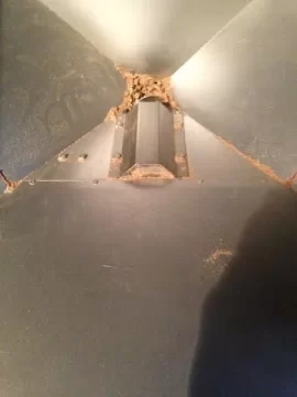

is it possible my stove doesnt have this photoeye option? i emptied the hopped and there is no cover plate except for the auger cover with the 4 nuts which hold it in place.
this is what the inside of my hopper looks like
The owners manual from Lennox only deals with the second generation of the stoves. The Profile 20-2 and 30-2. Your Profile 20 must be of the first generation.

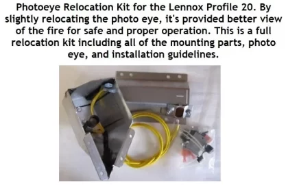

Please read this information about the photo eye relocation kit:
http://www.thepelletstovecorner.com...initial-start-up-and-the-on-light-blinks-why/
This is what the Profile 20 photo eye relocation kit looks like:

so is it true like said in that thread about it being a warranty part. probably not but maybe someone knows where to get one cheaper than 200
bucks
you dont "need" the relocation kit. the way its mounted now its looking through a slot in the pellet chute (about the thickness of a butter knife). Just check to make sure there's no sawdust up in the chute. You may have some difficulty trying to get it installed or covered by any type of warranty since you are not the original owner. I dont know if they ever offered a transferable warranty.
