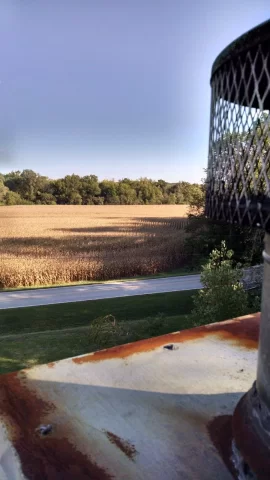

Who else cleaned there chimney today?
xman23
Oct 7, 2008
2,700
Lackawaxen PA
The plan has always been to clean the chimney at the end of the burn season. That's never happened. So today the roof shingles were cool so I got up on the roof. It was bad, opened up the stove, found 3 inches of ash, 2 half burnt pieces of wood. I don't recall ever leaving the stove not cleaned but this year we did. It wasn't me that did that, my wife is not real good at shoulder season burns. I'm not good at pointing out the issue, so I just cleaned up the mess. I top down, with a few ladders on the roof tied off to the chimney. Two new fire bricks and cleaned the inside of the stove to bare metal. Easier to check for any cracks. About three hours to do it all.
