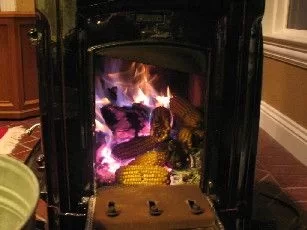

I also had great luck with burning eared corn in the TLC-2000. Had to get a good wood fire going first and then either toss a dozen whole (dry) ears in or laddel in some dry shelled corn.
Gotta watch it though, that corn can get hot fast. So you have to experiment.
I can also burn earred corn in our current stove (Heathstone).
ANyway to attach photos? I'll show you how it goes or you can go to this link and see my post on a corn stove forum for burning ear corn in a wood stove:

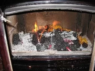

Marty,
"Pop corn" is a very different animal then yellow "field corn". Kind of like the difference between a grapefruit and an orange. Bothcitrus, both similar in structure, but two completely different fruits.
Pop corn is a completely different variety of corn.
Field corn will never 'pop' in a stove, as long as it is dried down below 15% moisture (which is what the grain elevators dry it to for storage).
Here is another photo for you.
