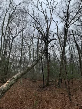

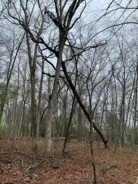

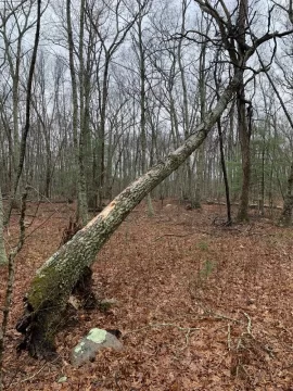

Hey guys I have a red oak leaner. I don’t have a tractor only a chainsaw and come along. How would you guys go after this? I was thinking I could use some straps to prevent it from falling to the side I’m cutting on.
Am I being too ambitious? Should I just step away and stick to the less dangerous stuff?

Looks like it is broken off at the stump.
If so I would pull it back with my truck or the come along
Looks like my ATV would get to it so maybe tie off the
ATV to a tree and use the winch pulling it back off the other trees
Hard to really tell from the pics but those little leaners look like trouble. I’d start with those. A longer bar helps breaking down leaners to keep you a little safer distance. Tying it off is a good idea

Looks like plenty of room to step back, I do these all the time by a top cut down to about 1/3-1/2 way through, put a wedge or two in that cut and then finish the cut so that it falls straight down. Then step back fast and see what the top of the tree does, rinse and repeat.

It doesn't look too dangerous to me. I would saw off a 6 foot piece at the bottom. Then, saw off another. After four times of doing that the problem will be solved.

Maybe it’s an allusion but don’t you see the tall little tree with all the pressure in the first pic? I’m not saying it’s a hard stop but it takes the easy peasy out for me
rather than go after it with my small home owner grade saw and comealong I'm going to leave her alone until I get a tractor someday and Ill try to pull it down while staying well out of the way. In the mean time the hassle is not worth the 1/2 of a cord or so I'd get from it.

I’d tie that to a truck in a second and pull it if I didn’t have a tractor.
would likely help if a log was placed on its butt to help lift the tree up off the ground as it gets pulled away
Ok. Then is there a little tree that’s going to get more pressure as you break it down? Possibly snapping and coming back at you? Or is it just the way the first photo makes it look
Then cut the damn little tree first!
That is the last thing I would do. To unpredictable.
I just did 3 cherry's like that. Under cut about 4' from the break, go to the top of bottom cut it drops down, repeat. Easy peezy
That is exactly what I would do if pulling it didn't work.

I agree completely it doesn't look to scary to me either but without being there it's impossible to be sure. I would start off by trying to pull it down then cut from the bottom piece by piece untill I could pull it. But I have the benifit of several trucks and a bronco with a 12000 lb winch. Those are the benifits of being a vehicle hoarder lol
I appreciate the advice gents but this one is staying put for a while, there is no reasonable vehicle access with out tearing chit up. I have plenty of other down wood to keep my back sore for a while.
I bought my first chainsaw this year and am completely new to tree work. If I can find some one experienced to help I’ll go for it but based on some of the feedback I’m getting I’m not going to take it on my own at this point.
Good Plan. If you think it's beyond your experience level don't do it. Be Smart and Safe. Don't get talked into killing or hurting yourself. I own Tractor and long wire and would just pull it free. Got similar to do right now. Drag it out and put it on my slash pile to burn this Fall.

A month ago I cut several dead oaks, and one ended up hung up. No touchy. Just looked, stared, and walked away. I noticed last weekend that the wind worked it enough to finally get it to drop, so was able to cut and gather it up. On the other hand, I can think of only one that after 10years still hasn't let go and become safe. It's just laying there at a 45 seems like from now and forever. So be it. The one you have, not sure, maybe snip off the bottom few 6' sections. But I bet the top would still stay hung. All that for little gain. Maybe walk away, stay out from under it, make note of it in passing, and wait for the day.
