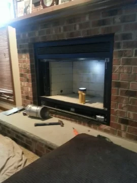

So I am thinking about upgrading to a BK Princess insert, i currently have a PE Super. The super slides right in with just enough room on top without hitting the metal frame on the old gas insert. I need about 2 inches more going up with the Princess, will it be ok if i take a saw and cut about 3 inches going up, i have about 6 inches of room, there is also a metal piece inside that i will have to cut as well. Will this be ok?

Old gas insert? How is the Super vented?
That's not an insert. It's a pre-fabricated wood burning fireplace.
You cannot modify that fireplace in any way, except removing the damper, smoke screen etc. Can't cut it or remove the bricks. I really doubt the princess will ever fit in there like it is. Do you have another location you could install a princess stove and just keep the fireplace for ambiance?

Because doing so is modifying a ul lised appliance and voids its listing. This makes it not meet code and in many cases makes it so your insurance will not cover and damage. I dont like inserts in zc units at all but you absolutly can not modify the zc in any way.
Also, just because it will physically fit in the hole doesn't mean it will work. You still need room to make the final connection, the princess has a flue collar that exits at 30 degrees. This makes it even harder in a situation like this.

The Lintel is 38" from the hearth, and as you can see in the pic in the begining of this thread there is a 2 inch brick lip in the back of the hearth, and what would i put to cover the huge whole in the fireplace with just the vent sticking out?
Another question, could i get a BK Princess Classic freestanding, its 27 1/8 high, put a 45 coming out of top, strait pipe it to another 45 and attach it to the liner, the stove will be sitting on the pad, see pic in beginning, and i would put a extension on to the requirements. Would that work?
38" from the hearth or the floor? You say the fireplace is 21" tall and the picture does not look like its 17" from the hearth to the bottom of the fireplace. If it's more than 33" from the hearth to the top of the fireplace opening you have several choices for large rear-vented stoves:

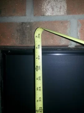

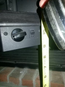

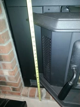

grisu, see pics for measurements, it actually sits off the ground 9 inches (from the hearth) and hearth to top is 38.
You are measuring to the top of the surround which is probably covering some of the bricks, too. Looking at your first picture, it is about 10.5 layers of bricks from the hearth to the top of the fireplace opening. That is the max height a rear-vent stove can have for the flue exit. See how much that is. The Woodstocks start at about 26.5"; above 33" you have pretty much free choice from the list I posted earlier; anything in between you have to check the particular stove. All those stoves are ~3 cu ft firebox and will give you longer burn times and more heat but you will also need more wood.

yes, we are about 11 bricks up from hearth, with gives us about 30 inches.
